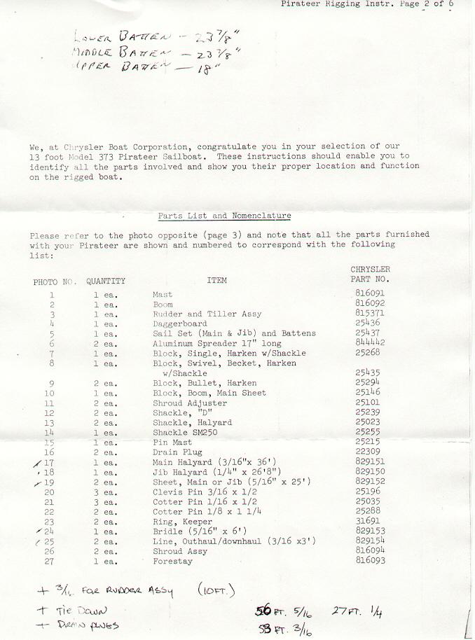

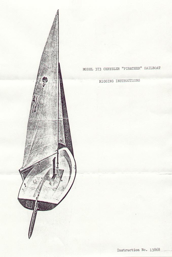

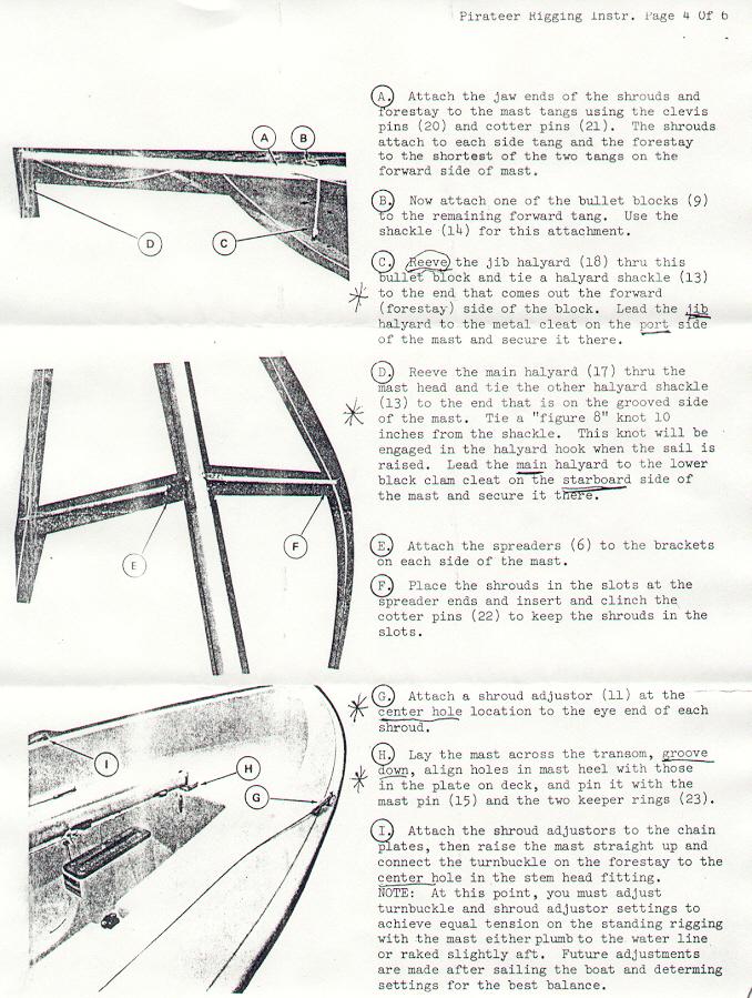

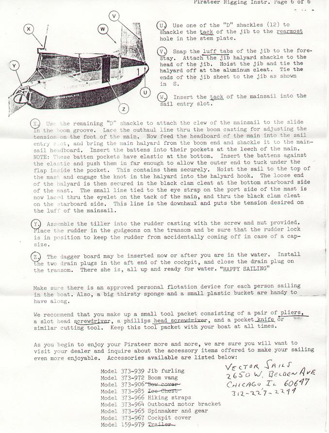

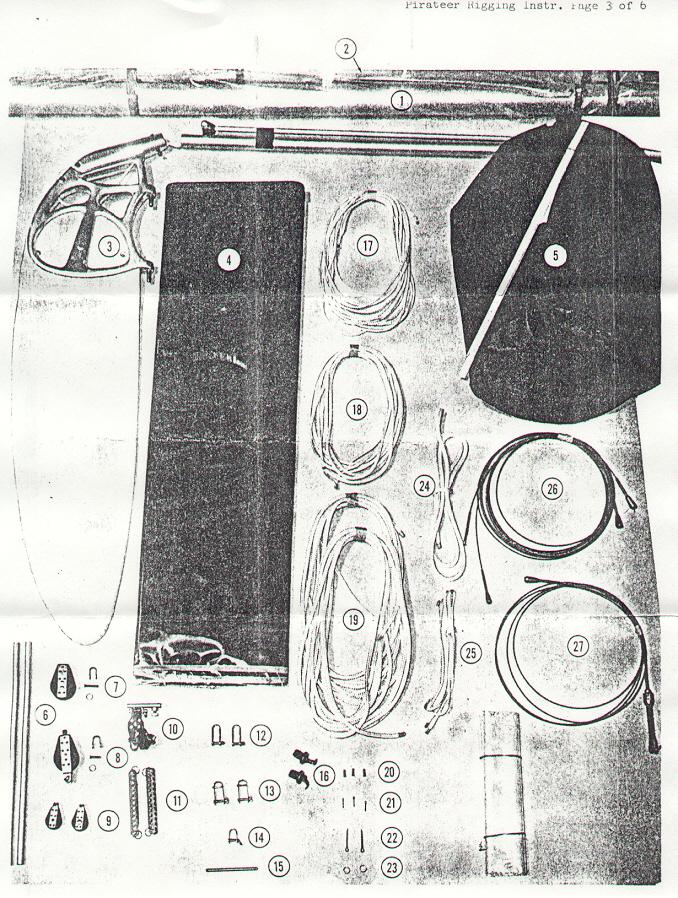

The drawings and equipment lists comprising the manual were too time
consuming to convert to .html format, so they were simply scanned and saved
as .jpg files. For your benefit, I've included the page numbers, descriptions,
and file sizes. To view the individual pages of the manual, simply click on
the descriptions in the table below.
