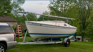

Bought this beauty almost 2 weeks ago. I've been really nervous about getting the mast up for the first time and going over all of the rigging. I was told by the seller that it is ready to sail, and from what I can tell with the mast laying down, everything seems to be there and in decent condition. I've read through the instructions on using the boom as a gin pole several times and think I have a good handle on it. Is there anything I should be worried about or looking out for? How tippy does it get on the way up? It has a mast hinge and bridals. I need this to go smoothly or I'll never convince the wife that this was a good purchase.

Nice looking boat and trailer. I'll let you know in 2 weeks when I try to raise mine for the first time on the C26 I bought this spring.

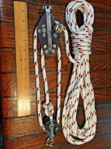

I've purchased very good double-braided poly from a seller on eBay (rags4jc) at super reasonable prices. You can get new and used hardware from him too and he'll cut the poly length to your specification
Here's one such deal going for $125
