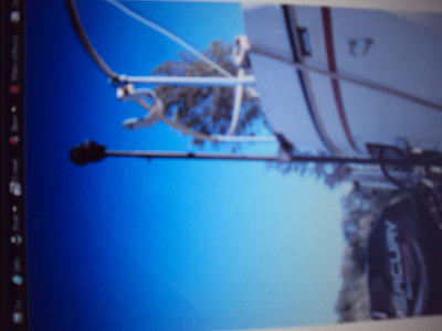

# 1 Is the mast crane made from a piece of pipe with a roller . The bottom of the rig just sits inside the motor mount. the pipe is welded to a channel that hooks over the transom with a cut out for the factory installed stern light. The channel was made from 2 pieces of angle bent and welded to match the curve of the transom. I put the roller on a scond pipe that sleeves into the base with a pin that allows for hieght adustment. This unitworks for trailering as well as set up. The roller allows me to slide the mast back untill I can attach the mast base to the step. The boat does not have the original step but uses a hinge pin. (IMOH Much safer)
