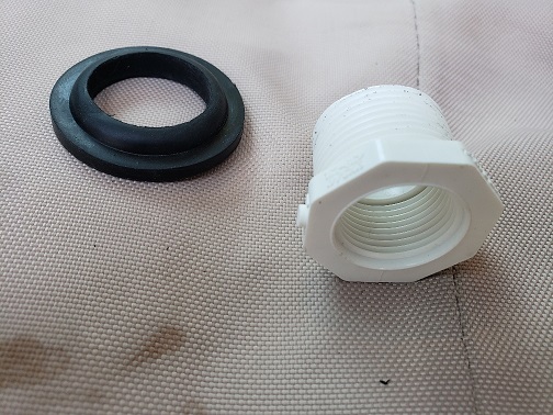

Ok, I'm not sure if even 3/4ths would have been large enough. Since the ends of the back stays are two prong, they don't fit down the middle. In any event, I think I measured where the holes in the bimini go correctly, but the backstays ends didn't fit through the grommets, so I had to remove the grommets. Then I used matches and melted the edges of the holes, then I put a small square of Gorilla tape on each side with an asterisk cut into the center so that I could fold each prong back of the tape to make the hole.
Next, I went to the hardware store and bought some 1" threaded plumbing pieces and some rubber gaskets that fit tightly around them and plugged the whole resulting in a hard plastic guide where the back stays go through.See pictures I may put some glue on to make sure they don't slip. They are pretty tight though.
