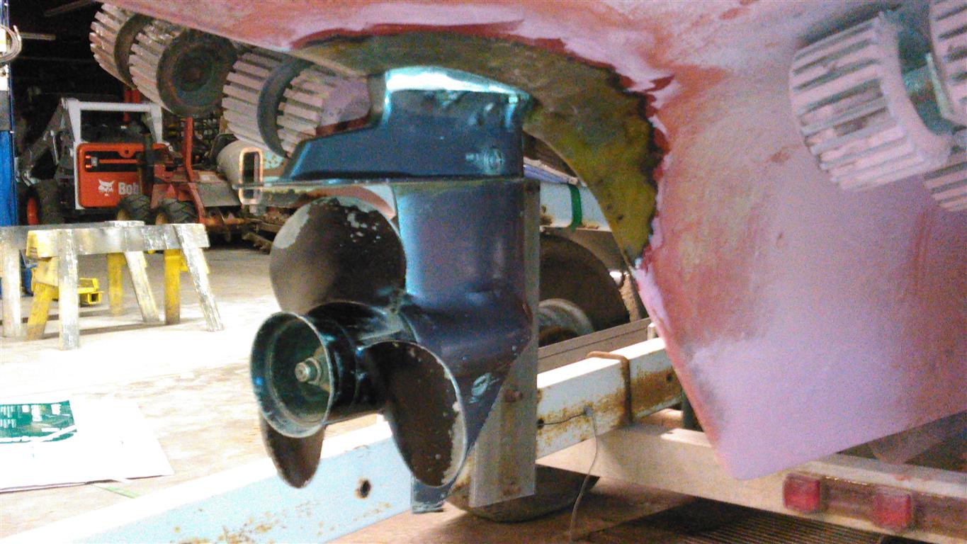

If it is coming from the aft stern area then it most likely is the motor mount area, this is a problem area for the 26. The chain locker is under the forstay forward. This has a drain that goes out the front and if it gets plugged the water sits there and eventually finds its way down. I closed off my motor mount and made a Honda generator locker out of it. I am running an electric motor and a lower unit mounted to the hull just aft of the keel.
