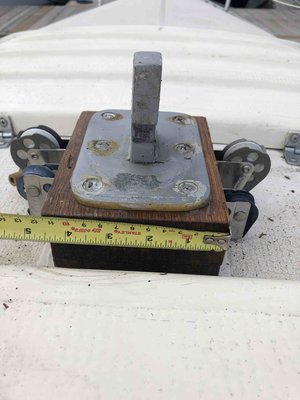

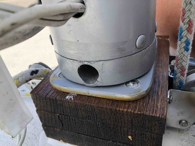

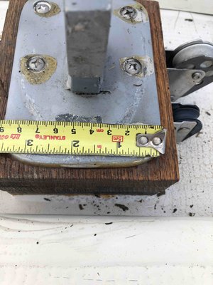

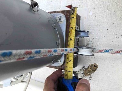

No idea - will be easier to see some pictures.........below are some from my mast base; which is the portion that broke?
Now, maybe will be the opportunity to install a Mast Hinge instead?

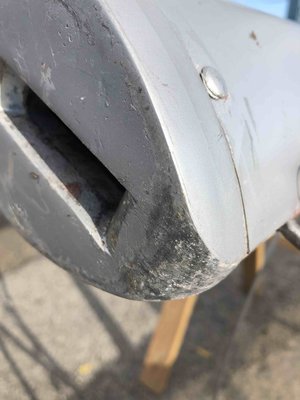

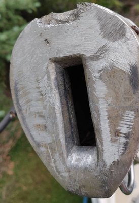

Here are pictures of the damage. I have not been able to find a replacement part for just that foot piece. Does anyone have any suggestions?

Doubt the part itself will be available;
You may need to consider a Mast Hinge; I'm also looking at that for next season; if you zoom-in the picture of my mast, you can see there is a crack starting to form in almost the same shape of yours so I won't be surprised if my mast is close to have the same failure......
there are a couple of threads here about mast hinges --although some are dated--

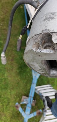

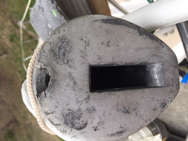

+1 on the broken mast foot! Photo attached (I hope). I also looked for a replacement part but had no luck.
I was however able to raise the mast using the pin and a wooden gin pole that I shaped the end of to fit around the foot of the mast and with a ratchet strap to hold it tight and in place. Pretty sure I got the idea somewhere on this forum. I later saw someone on the forum who had attached a metal strip around the foot of the mast with a hole in it for the pin to fit through. I thought that was a pretty good idea. I will be installing a mast hinge before my next mast stepping and I'm hoping that will help keep things in place!
By the way, when unstepping the mast using the oem hook make sure you support the weight of the mast for the last several feet on the way down...I did not and it pulled the hook right out of the deck. I am still finishing the rebuilding of my mast step from that mistake.

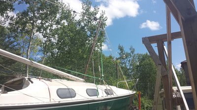

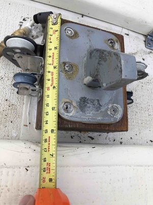

Bunch of pictures.......

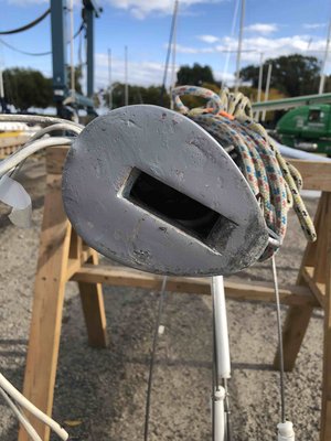

Post by CLS72 »
More
