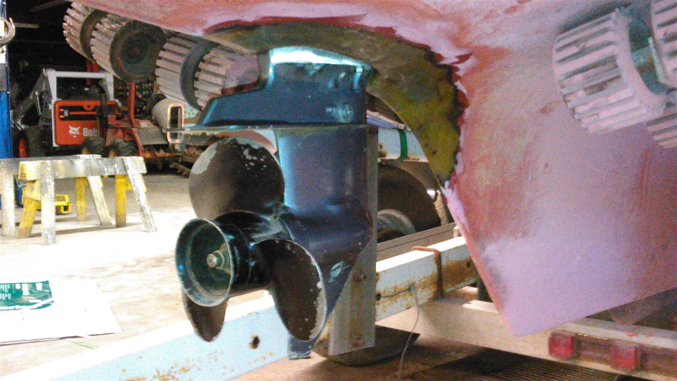

If it is coming from the aft stern area then it most likely is the motor mount area, this is a problem area for the 26. The chain locker is under the forstay forward. This has a drain that goes out the front and if it gets plugged the water sits there and eventually finds its way down. I closed off my motor mount and made a Honda generator locker out of it. I am running an electric motor and a lower unit mounted to the hull just aft of the keel.

Yes, true enough the leaking is from the motor mounting area. When under motor power I crawled down in the aft section while my wife was trooling around and there is a steady trickle coming right in the furthest reward section where the board ( transium ? ) meets the flooring, this is draining to the where the rudder goes into the haul, which is draining to the keel. Not sure any type of further repair is going to be possible till I pull her from the water.
Bilge pump ( one that works anyways ) is able to keep up with out any issues, and when under sail the leaking is not present, so as long as I am able to keep her working like this, I will probably wait till fall when she is pulled to find and repair my leak.

I have a 26, fixed keel. when I put her back in the water last year, it only took 30 minutes to fill the bildge. I quickly found the leak at the base of the hose that isolates the rudder shaft from the aft berth. Temporarily used a caulking and fabric with Zip ties to seal up. Then when returned to trailer removed temporary fix and re-fastened the big hose clamp ( with some caulking under the edge to seal). I installed 2 inexpensive Rule pumps for redundancy. Made sure that they are rated to lift the water enough to clear a sailboat bildge.
