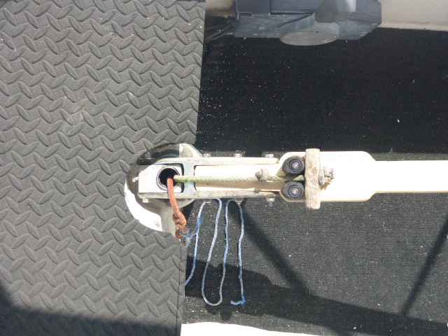

This seems like an obvious question, but I've yet to see it asked on the forums. I'm starting to save up for a Chrysler 26, and the one thing I can't figure out is how you motor in shallow water with the rudder up and motor down. It seems like the rudder would hit the motor when it's straight.
Thanks!
Rudder Up, Motor Down
Re: Rudder Up, Motor Down
I prevent this by squeezing the 'down rudder' line in a cam cleat. See picture
