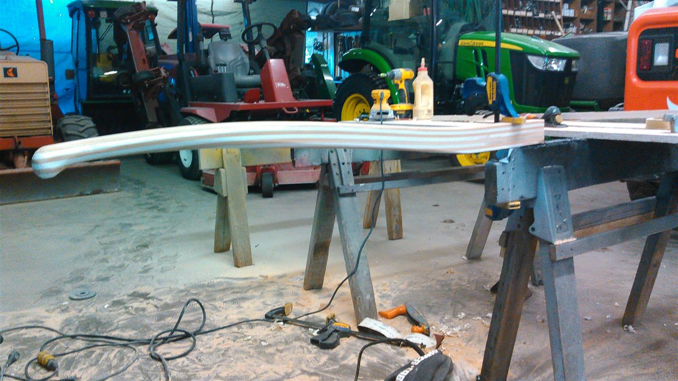

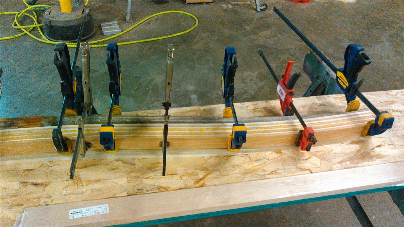

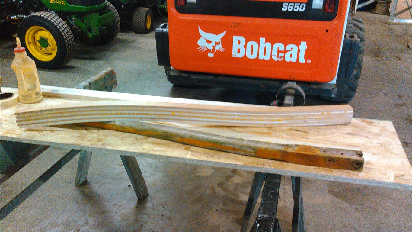

Making a new tiller is easy.

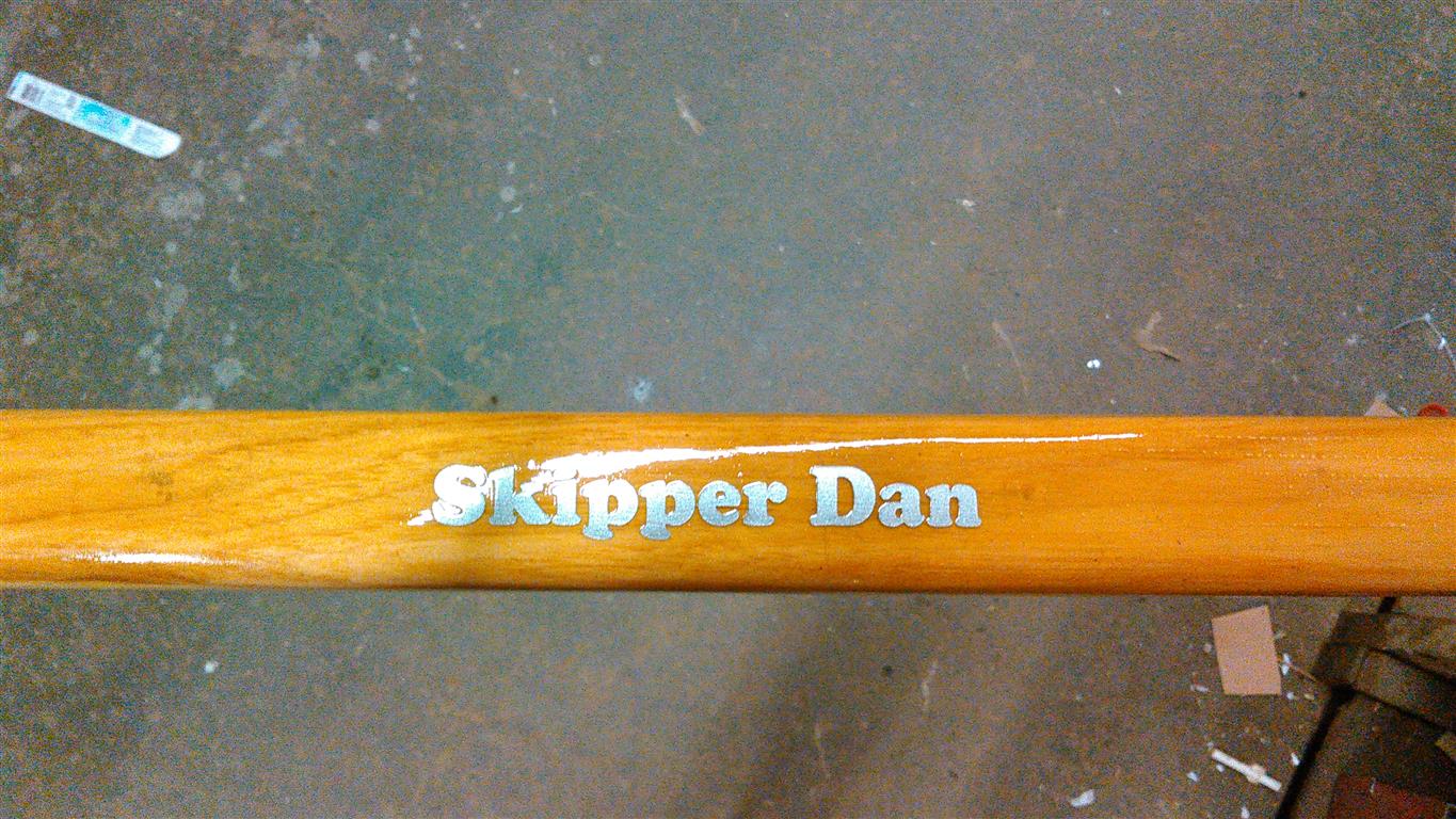

Very cool!
I love the custom name on it!

I wrap the lower part in fiberglass and overdrill the holes and fill them with epoxy. It is the last tiller I will need.
add a tiller cover from left over Sunbrella
