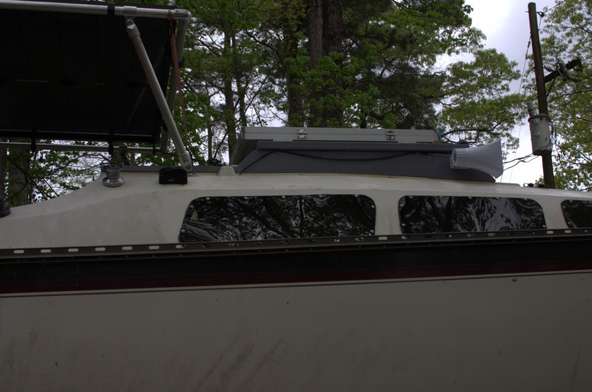

Bought an extra wench same size as factory ones on the C22. Looking for ideas on a place to mount it to help with single handing the boat. I'm thinking using it for the main. Will probly put a roller furler on the head sail.
77 Chry 22' S.W KS
- Posts: 138
Re: Extra winch for single handing
You should already have two to single hand the boat sailing. If you are talking about bringing the Halyards to the cockpit to raise and lower the sails this is where I put mine and is pretty standard on cruising boats. You need two standup blocks and a double deck organizer plus a double cam cleat.
