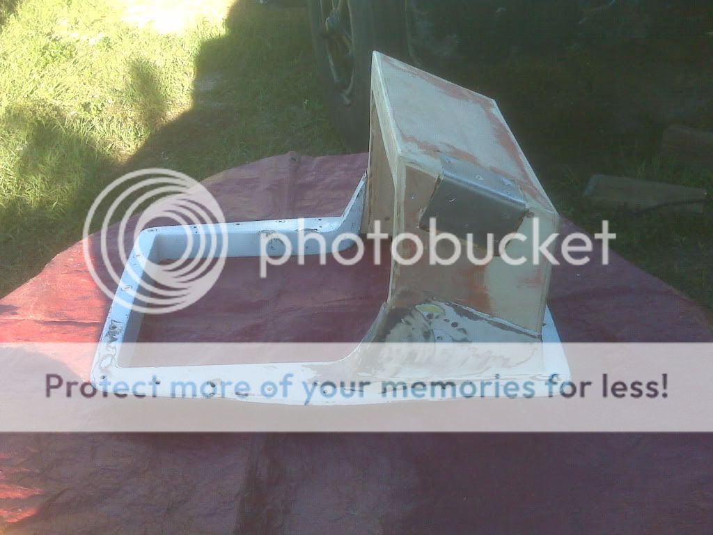

I have a few, new to posting pic. so here is my first try
Dave
http://i866.photobucket.com/albums/ab22 ... G00249.jpg
http://i866.photobucket.com/albums/ab22 ... G00252.jpg

I am looking at a Chrysler 9.9 but no elect. start so my 3 alternatives are
1) Mount an outboard bracket which will raise and move out so it can tilt
2) Rebuild the mount on the back of the hull
3) get an engine like a old 9.9 2 stroke 70's vintage Johnson or Evinrude which has a low profile cowl but as old as they would be they might not be dependable and most were short shaft. also if you had power head problems
you would be right back here with option 1 or 2. I think short term to go with option 1 and reinforce hull mount and find and modify a used mount
or make one from scratch to fit but I don't want to miss sailing weather.

Dave,
Interesting mod. I was focused on enlarging the hole in the transom but putting the motor farther back might have the same net effect while being a bit easier. Thanks for the idea.

Tom I am cautious on enlarging the hole as you would lose the support on the top of the opening and might lose some structural strength.
