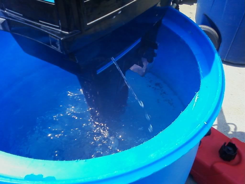

Just finished work on mine today. Major success! See that little tell-tale stream? Didn't have that before. Runs like a top! Woo-hoo!
Mark
Is the tell-tale the only place I should see water coming out? Should it be coming out with the exhaust as well?
Mark
- Posts: 2954
Mercury 9.8 Circa 1980-81.
Mark
Finding pea sized gobs of oily muck (dirt) and dead bugs floating in the water after running it. Exhaust smoke coming out fine, especially when I'm sraying cleaner down the carb.
Water way is fine into the top of the water sleeve, got all the pieces of old impeller out of the system. Has a location for a thermostat, but none there right now.
With a few oily gobs of dirt and bugs coming out, makes me wonder if there should be some flow, but got clogged by the last guy running it through the mud. Just can't figure how it should flow through the water sleeve???
Mark
you should be fine if it only gets warm at the tell-tale if it gets too hot to put hand in that is when you worry.
