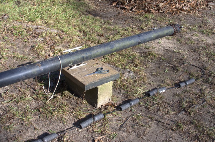

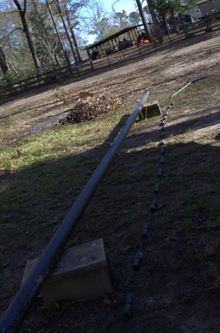

The first project was new wire in the mast with new connectors. I rebuilt all the lights with LED. I'm also adding a deck light. This shows how I reduced the wire slapping noise in the mast.

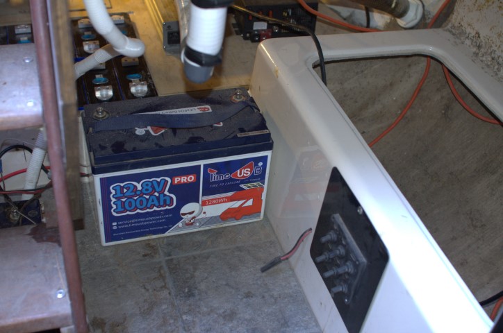

Today I installed the battery cells. These 300 Ah cells fit into the same box that 4 of my 100 Ah Lead Acid batteries were in. the weight is about the same as two of the LA batteries. It took 5 LA to get to 60 volts. The 5th one did not fit into the box where as these LifePO4 cells all fit into the box giving me 60 volts. The LA batteries were good to about 50 to 75 Ahs. These will go about 275. I had a 300 Ah LifePO4 and a 100 Ah from my camper. So in total I have 1900 Ah of batteries available. The big 60 volt bank will feed the motor. The 300 Ah will feed the house (Frig, freezer, computer, and lights. The 100 Ah will be for the boat electronics and running lights. The 60v pack will also be able to feed the 300 Ah house via a dc to dc charger. I have 3 solar chargers one for each bank. I also have 3 110v chargers that I can run off the 3000 watt generator. 60v 12 amp, 12v 80 amp, and 12v 40 amp.

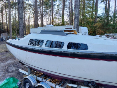

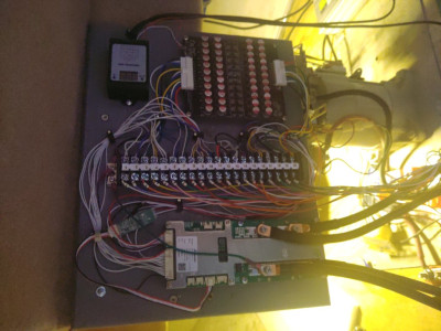

Well the weather is finally warming up. Installed the new leak proof windows. Fabricated the companionway cover that doubles as my lower solar rack. Hopefully tomorrow I can get the new forestay anchor roller installed. I have most of the battery, BMS, equalizers and other controls installed.

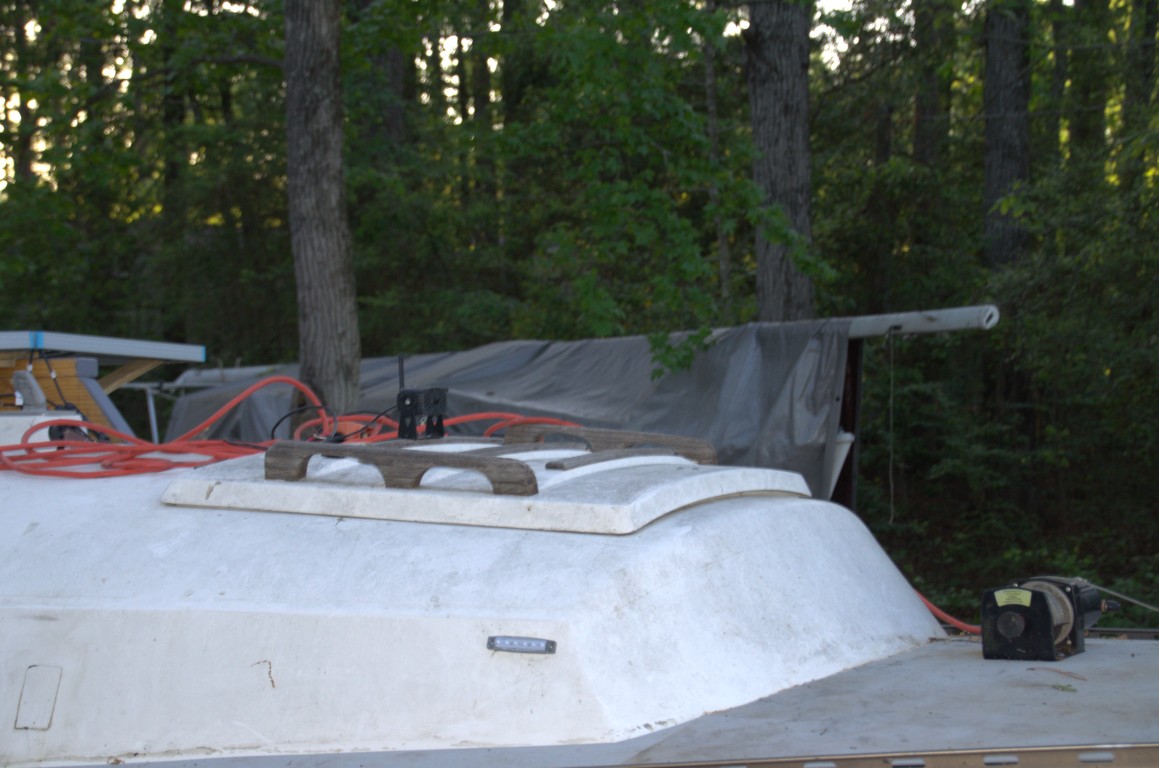

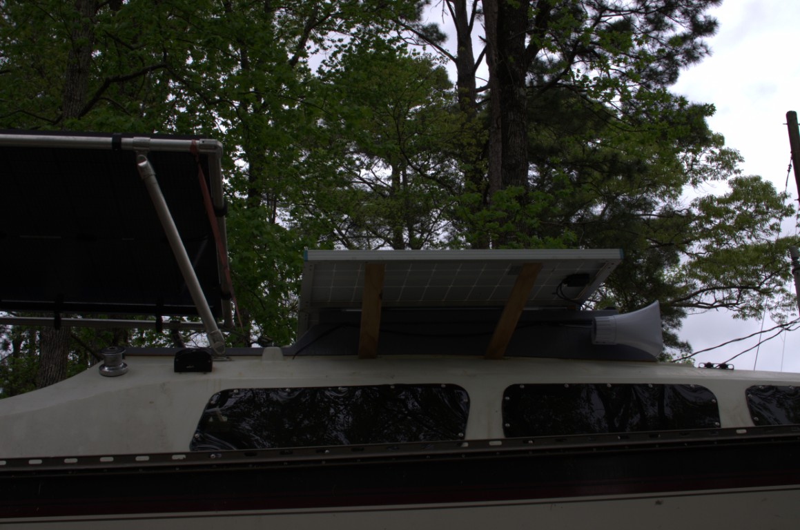

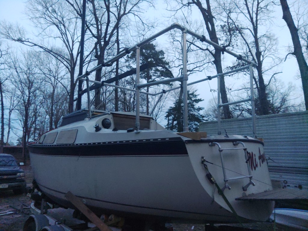

big day today as I raised the mast with my deck mounted electric winch. It worked pretty well, but I am still on land. It may be a little harder on the water. I won't have to go all the way down so that will help just far enough to get under bridges.
I also go the upper solar rack set up. A few more parts to go then I have to make the bases for the mounts. I think it is going to look pretty good. I will epoxy weld the fittings to the pipe for added strength. I will not have standing room under it. It was very close but I did not want to get too much closer to the boom. I just have to duck a very little bit. Standing in the companionway I can stand all the way up. I still have the rear rack to go. This hopefully will double as a kayak lift.

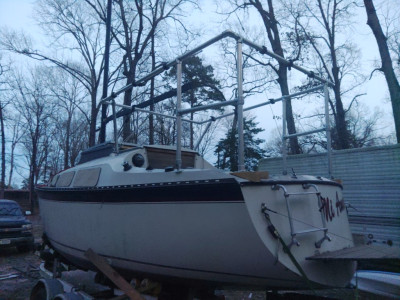

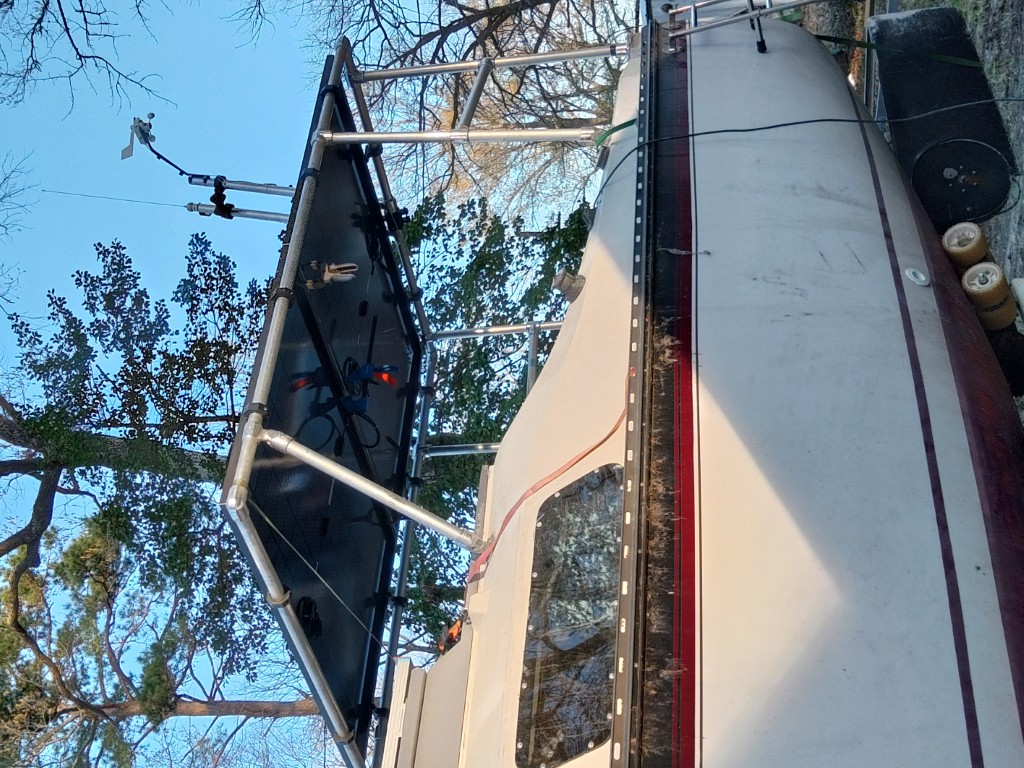

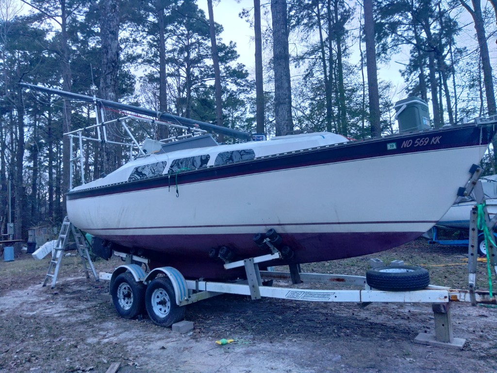

Re: Getting the 26 ready for some serious sailing
I'm really happy with the solar rack. I have one more panel to get up. It hinges out the back, It could come off if need be because of weather.
Also I got the wind instrument installed, side boarding ladder, and Pulpit. I'm going to work on some canvas enclosures for the rack. I'm not sure why it turned the photo, just click it and it comes out right side up.

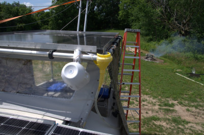

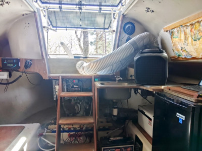

I made an extra panel for the companionway for the AC tubing. Seems to work rather well. Taking it from 80 outside to 70 inside.
I have the freezer full and going, (White container under stove top). Frig is half full and going. Battery is full so I am going to let the AC run all night with both freezer and frig going also. It should give me a good idea how many amps I would used overnight. The AC also works as a heater so if it were to get cold I would also know how warm I might be able to stay. I've been always interested in going through the Straits of Magellan so it would come in handy there.

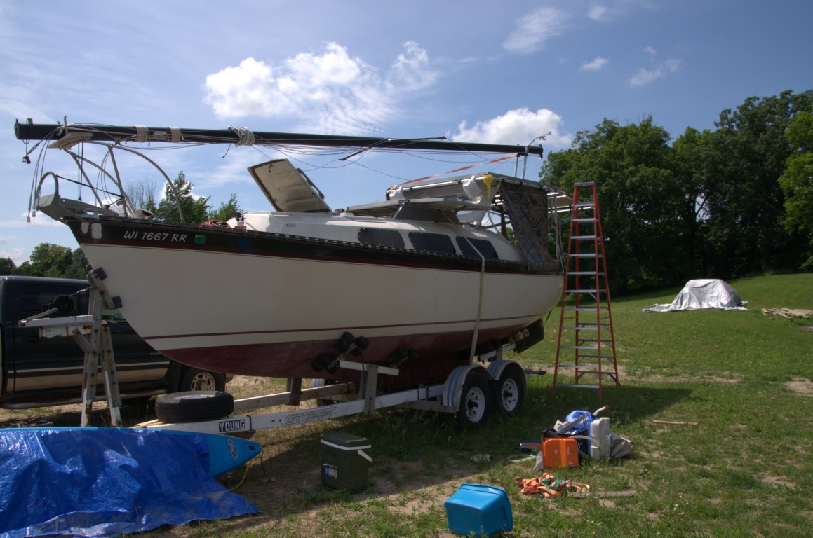

I have the solar panels hinged now. They can fold up for sailing. I also brought the halyards to the cockpit. I redid the boom so that I can reef from the cockpit also. I installed a sheave in the slot for the main outhaul so I can adjust that while also in the cockpit. I am thinking of two more panels to go over the folded ones while sailing so I do not lose solar while sailing. These will fold out so I can use them while at anchor giving me 200 more watts for the house battery.

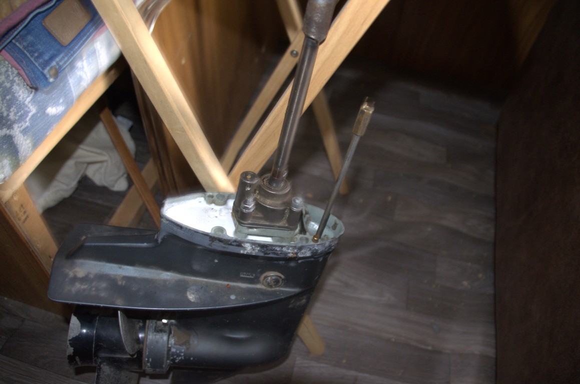

So I sealed up the lower unit the wrong way the first time. I sealed it from the outlet of the exhaust and somehow water still leaked into the lower unit trapping it. Over the winter is froze and broke the two attach bolts. I did however find out through trying to find a replacement part that I had infact a sail drive lower unit. This came with a high thrust prop and looks to be a little beefier than the regular lower unit. I found it kinda odd that I found the lower unit in ND where there is not much sailing done. The replacement part (Prop shaft bearing housing came from France.) I was lucky to find one. Now I sealed it from the top so if water does get in it will just drain back out through the exhaust. I did this conversion back when Electric conversions were just getting started. Now you can find electric pods in the 7 to 10 Hp range that would do away with having to convert. Just bolt the pod on to the hull and your done. Most likely more efficient also.
