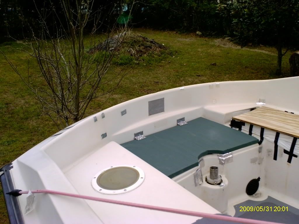

I made a new lid for the aft hatch ( lazarette I have seen it called). I used the original to make a mold out of MDF which I patched with body filler then waxed several times and finally coated in spray vegetable oil. This is my first ever attempt at fiberglass, I think it came out pretty good. I also cut a piece of treated 1/2" plywood to fasten to the underside of the hatch. My problem now is how to finish it. Gel coat is real pricey, and matching the color seems tough on a '78.
/Here are some pics of the original hatch, the mold and the unpainted new hatch.

Wet sand the gel-coat with 1000 grit to get your true color. what you might need to do is get white gel-coat and tint it. coat a small spot then have your wife look at it and tell you what tint needs to be added ( woman see colors better then most men)

Finished my hatch, gel coated and all. Managed to match the finish using white gel coat and a touch of brown colorant.
Question now is, what should I use to glue the pressure treated plywood to the underside for reinforcement. 3m5200 or liquid nails? Maybe something else, little help please.

When I repaired my hatch I laid a piece of fiberglass mat inside and a little extra around the edges to run up the lip of the hatch. I used 1/2" marine ply and cut the piece to the inside of the lip by about 3/8" all the way around, then I used a 45 bit with a bearing to relieve the edge. Fiberglass does not drape well on 90 edges and I wanted to cover the ply with 8oz cloth on the bottom surface and roll the cloth into the lip. Anyway, I saturated the mat with polyester resin and painted the face of the ply with resin then clamped the ply in place, working the mat around the lip. I left it clamped overnight, roughly sanded the exposed fiberglass then laid out the piece of 8oz cloth, painted the ply with resin applied the cloth and finished saturating the cloth using a cheap bristle brush with bristles cut short. It is very strong now.

I put down 5 layers of gel coat. I was only planning on 4 but I tinted every layer and the fourth was to dark, had to do one more to get the match right
I was real impressed with how easy it cleaned too, I used my hlvp gravity cup gun and was concerned that it would be ruined, but a bit of acetone through it and it's squeaky clean.
