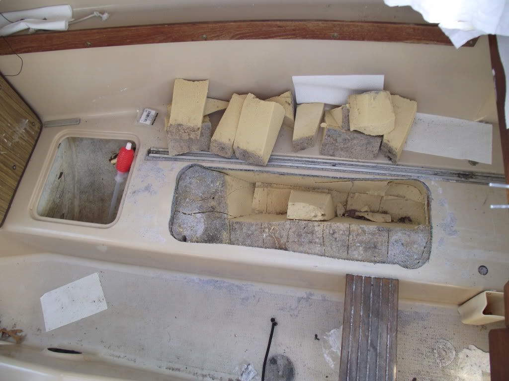

Just got the boat back in my driveway last night. Pulled out the camera this afternoon and here are a couple of shots, as promised:
Plain to see, I cut open the top of the settee along the track for the sink unit. I'm planning on opening the side as well (Yeah, probably the side towards the keel trunk
) so I can get at the foam easier and have a side hatch for storage. I'll beef the whole thing up with a frame inside and lip around the top opening to place a cover, like what goes on the bilge.
Like I said before, the foam holds water like a camel! It's all coming out. Wish there was an easy way to get it out! Like Alan said, some type of chemical that would eat it up, but not bring the EPA or Homeland Security storming my house. Guess it's the armstrong method. More pics as I progress. Lots of wind and rain in this weeks end forcast, so probably working on the motor in the basement...

I pulled out just about all you can see in the pics. Filled two 40 gal garbage bags! Released fairly nicely from the glass inside the cavity, maybe because of all the water saturation. Oversaturated at least three inches deep, drained it through a drilled hole in hull.
Here's the bad news, water wicks up the foam most of the way up the sides. I might be going in after ALL of it afterall. Dagnabbit!
Stuff is pretty heavy, probably 15 lbs per bag.
I'm likely to finish the job from the top--can't imagine going after it from the side. By the way, the side is plywood on the inside, top is just double walled glass with corrigated paper honeycomb (see pics above.)
