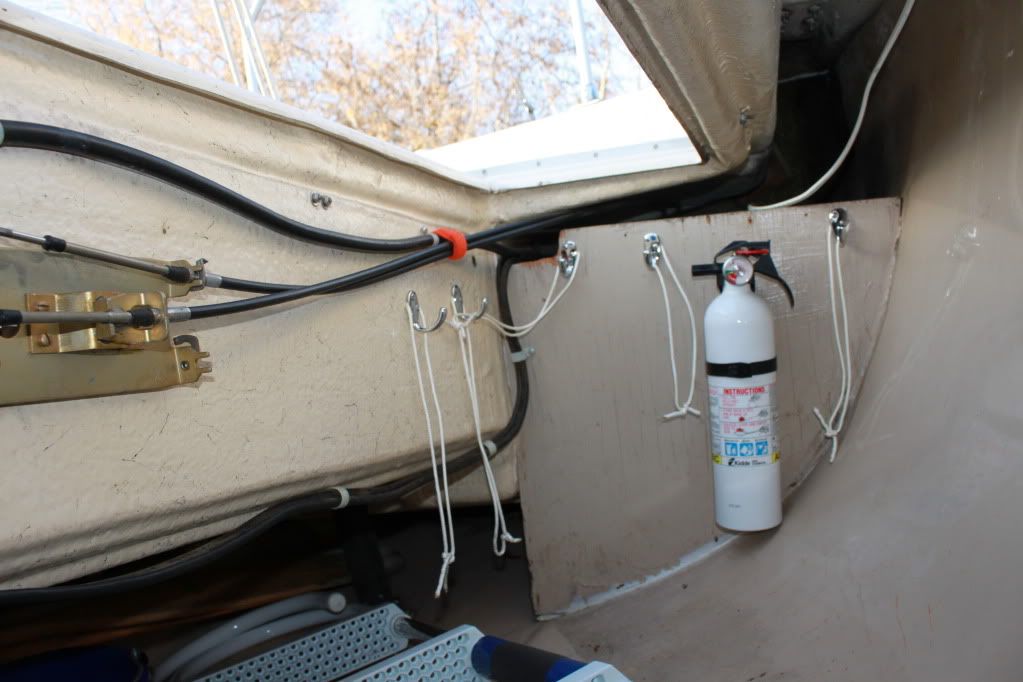

PO of Happy Place made extra large backing plates for the back stay mounts. Looks like he did not have the insite that the folks here have to use sockets with extentions. I still have a Channel Lock plyers hanging from the last one nut he tightened :shock:
As for the plywood "dividers" I have them also, with foam behind them.
Makes a great place to hang stuff in the locker.
I hang dock lines and sheets on the hooks
