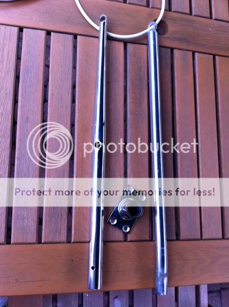

Travis, thank you for the offer...I'm in the process of re-beding and replacing the stanchion bases and all of the life lines etc. they are all original and have seen better days. I originally ordered just new bases from a co. in FL for a very reasonable price (think it was about 6 bucks a piece) and I ordered for 7/8" diam. since that was what was on the boat to begin with. However I had a really hard time finding 7/8 stanchions or tube, when i finally found the material it was 12 bucks a lin. ft. and then add in the eye at the top I was looking at well north of 40 bucks per stanchion.TravisJ wrote:Are you looking to relpace one, or all of them? My C22 does not have stanchions or lifelines (it's a fin keel and lives on a lake), however the previous owner had acquired a set he took off of some other boat and had planned to install them. They've been sitting in my attic ever since. I couldn't bring myself to drill that many holes in my deck. If interested, shoot me a PM.mariner wrote:Has anyone replaced their stanchions? I'm looking for a replacement and am trouble finding a source. I'm looking to replace with the same as oem 7/8" mine are bent up.
Ultimately I found new 1" stanchions on ebay for 6 bucks a piece and just got new 1" bases (I ordered 1" bases from the same manufacturer that i got the rest of my hardware from but the 1" bases were not the same quality as the rest...had to send them back and finally got 1" bases from TACO metals that are good quality but double the price)
So all in all I got new stanchions with accommodations for two life lines, or as I like to call them - edge of boat guides and bases for 18 bucks a piece.
new and old stanchions

Those look real nice Mariner, can't wait to see the installed photos in the near future.
Alan
