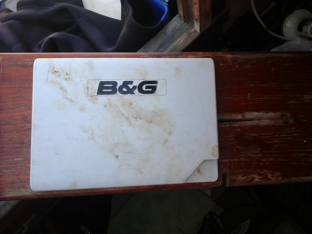

This is what I did in my Triton. Made an extra washboard and mounted the chartplotter in it. Enables me to see it in the cockpit, plus can be turned around to be viewed in the cabin for anchor watch at night. Also easy to pull the board out and replace with the original one while not at the boat. Just cut a notch at the bottom for any cabling.
