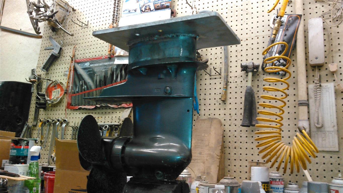

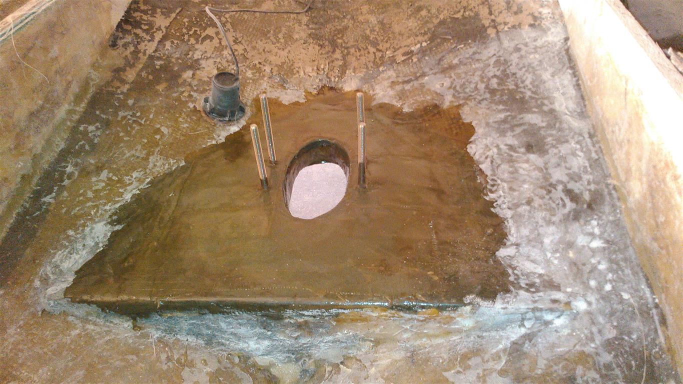

Skipper Dan, I can't figure out what your picture is showing, beyond the prop. Did you cut a hole in your hull forward of the rudder for the motor shaft? If so, how did you water seal it? What does it look like inside the cabin?

I have an electric drive, I used a 9.9 lower unit and mated it to the hull just aft of the keel. the prop wash goes over the rudder so steering is very good. the lower unit sits behind and above the keel so it is well protected. I would never go back to an outboard. I can motor sail all day. I always have power instantly if needed and usually have it on just spinning with very little amps so I do not have drag.
- Posts: 138
Re: Motor down, rudder up
I welded an aluminum plate to the lower unit. This is sealed from the platform in the post above. Also it is sealed around the lower unit itself with butyl tape for sealing windshields. I have never had a leak.

By the way, I can unbolt the lower unit with the four lower bolts and replace it if I need to. The fixed part never needs to come out.

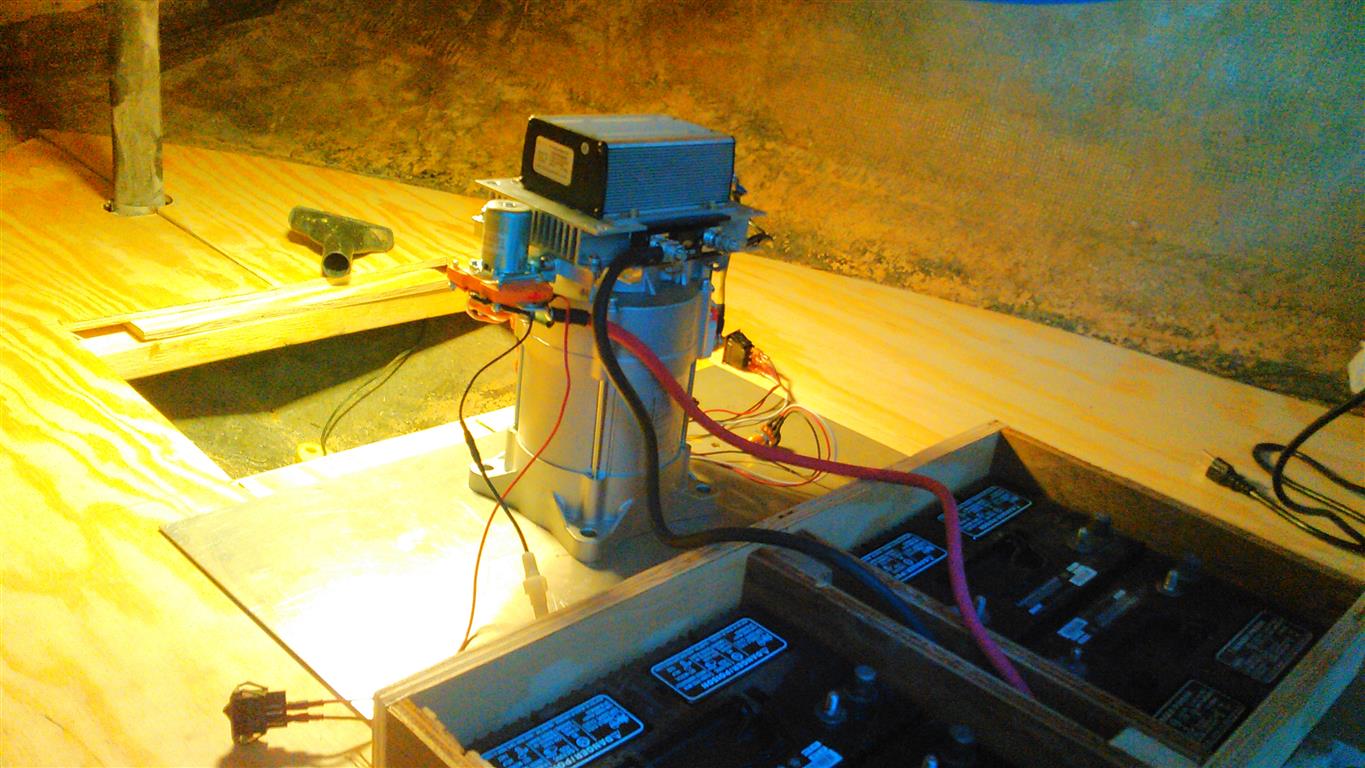

Wow Skipper Dan that's fascinating. What kind of motor did you get?
- Posts: 138
60 volt AC induction motor brushless.

I think you mean 60v DC motor per the product page. That motor shows 3 kW (4 hp), drawing 50A at full power.
If you had (5) 12v 200AH ($300 and 120 lbs each) batteries that would exhaust them in 4 hours at full power, wouldn't it? Do you have bigger batteries than that?
I suppose you could run it for 12 hours if you had a 2000W inverter generator, which would still be quieter than an ouboard if you ran more than say 2 hours and you could put it wherever you want. It would be a hybrid boat!

Well it is a sailboat, full power is more like 80 to 100 amps. I have never run it that high you are just pushing water at that point. I can run it at about 4 mph which is a good clip for my boat @ I think it was about 40 or 50 amps. mostly I run it at 2 mph that's 10 amps. I use cheap menards Exide batteries group 27 6 of them 5 for the 60v system and one for the 12 volt house. the 12 volt feeds off of the 60v via a step down. 6 solar panels keeps them in balance. I have a Honda generator that I used to use 2000. that would keep me moving with the on board 10 amp 60v charger. But I am building a diesel alternator @ 60v about 25 to 35 amps. If it works well I will build a better alternator at about 80 amps. That means that I can charge the batteries in about 30 min to an hour between 50 and 80%, the area that the batteries will accept the most amps. The key really is to not use the generator at all. But it is there just in case. 10 hp Diesel ICE takes very little fuel. Batteries are less than $600 and last 2 to 3 years. I might go with Trojan 12v @ $165 next year just to see the difference. My whole system is based on living off grid not traveling by prop power. The batteries are mostly for the house, the prop is just an extra advantage of my system. By the way the lower unit was Free! and my Diesel alternator will be about $500.00 and will blow a generator out of the water. speed control is a simple https://kellycontroller.com/shop/contro ... ntrol-box/

It is an AC induction motor, "AC Induction Motors with Encoder" you can run it AC or DC. They do not have my motor anymore it was rated at 100 amps for 2 min. It all comes down to heat and how you get rid of it. The whole difference between what I have (Hybrid) and a 10 hp ICE outboard is you still have to buy fuel and you rely on it starting when needed. You also have it hanging off the back end. If I just rely on solar This system does not cost me anything and is much more reliable. I need the batteries anyway for the house side, (I have a 110v refrig). I designed this boat as a liveaboard for doing the Great Loop. It may be hard to understand until you try it but there is something about just turning a knob to use the prop at any time. No starting up the motor that may or may not start at the most inopportune time.
