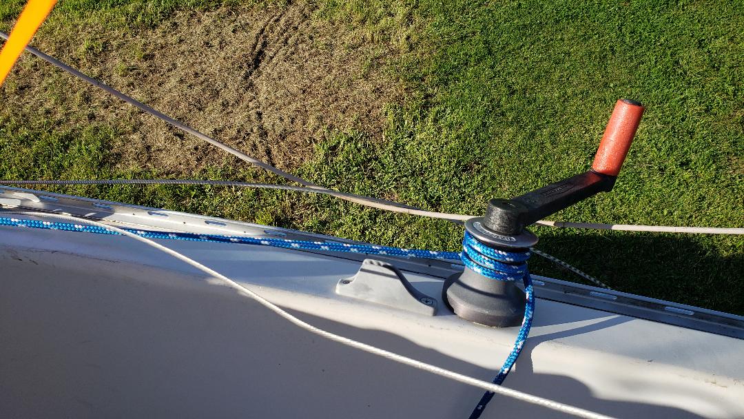

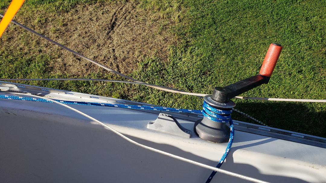

Finally got around to posting these images of mast raising on my C26. Took me a while to figure out how to get the mast supported properly on the stern in order to move it back far enough and get at the proper angle to ensure the mast went into the mast step hook properly. I ended up building a support that sits on the stern seat area in the cockpit. Hope these pics help someone. I followed the original instructions in the C26 manual to set up the rigging, hardest part was sorting out the support I needed. Was able to raise the mast with just my wife and son, their job was to make sure the mast did not go east / west (it has a tendancy to do that) while raising, and also ensuring the rope stayed attached with pressure to hold the mast base against the mast step hook (you don't want that falling out). I also ran the hoisting line back to the genoa winch on the starboaard side from a pully on the bow, that worked out great.
I'll post more images in a reply post.
Otherwise, go slow and back it down if something does not feel right. Don't recommend this on a real windy day and have the boat level when raising. :D
Kyle

And finally, it's up! Kind of a pain with a roller furling versus a normal forestay, but it worked as the roller furling housing had to be pushed to the side and pulled up the deck as the mast came up.
