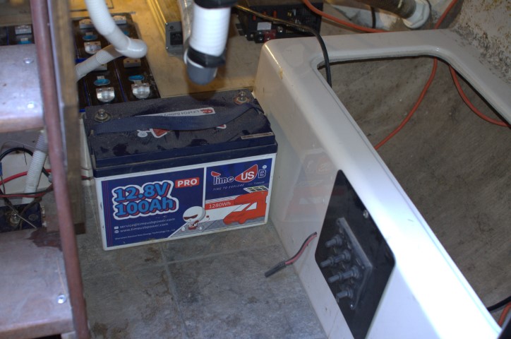

Today I installed the battery cells. These 300 Ah cells fit into the same box that 4 of my 100 Ah Lead Acid batteries were in. the weight is about the same as two of the LA batteries. It took 5 LA to get to 60 volts. The 5th one did not fit into the box where as these LifePO4 cells all fit into the box giving me 60 volts. The LA batteries were good to about 50 to 75 Ahs. These will go about 275. I had a 300 Ah LifePO4 and a 100 Ah from my camper. So in total I have 1900 Ah of batteries available. The big 60 volt bank will feed the motor. The 300 Ah will feed the house (Frig, freezer, computer, and lights. The 100 Ah will be for the boat electronics and running lights. The 60v pack will also be able to feed the 300 Ah house via a dc to dc charger. I have 3 solar chargers one for each bank. I also have 3 110v chargers that I can run off the 3000 watt generator. 60v 12 amp, 12v 80 amp, and 12v 40 amp.

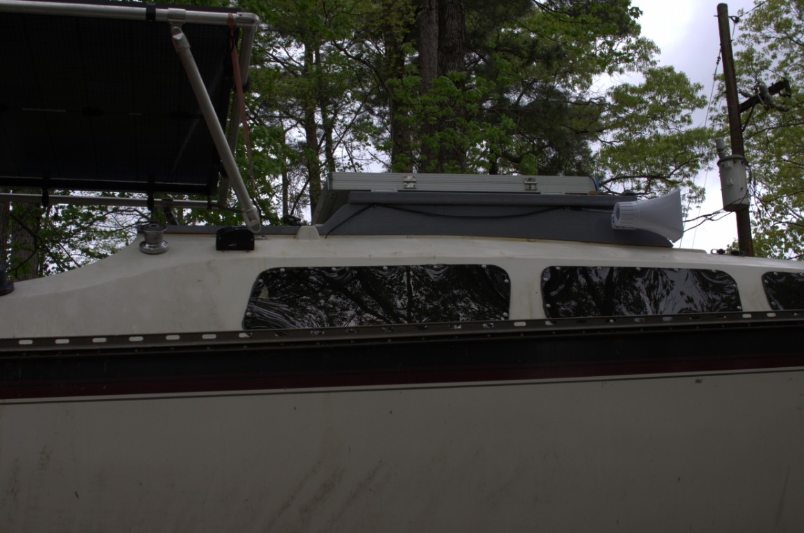

Well the weather is finally warming up. Installed the new leak proof windows. Fabricated the companionway cover that doubles as my lower solar rack. Hopefully tomorrow I can get the new forestay anchor roller installed. I have most of the battery, BMS, equalizers and other controls installed.
