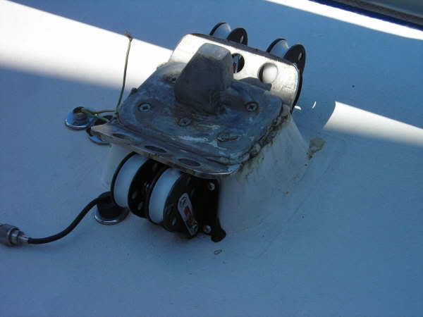

Here is my mast step.
Tom

robinsonzak
- Posts: 37
- Joined: Wed Dec 24, 2008 8:55 pm
Mario G
