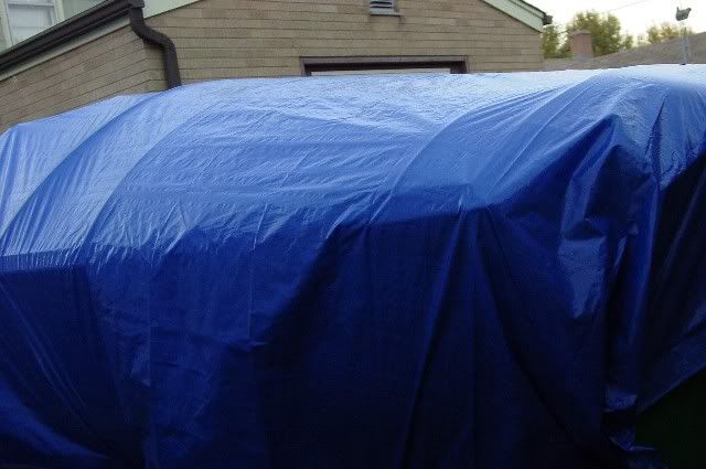

Tony, I took off all my stanchions and stern push pit and bow pulpit.
Next I cut three, two by four lumber and ran them length wise from the companionway wash boards to the aft pushpit mounts and center of transom. I attached the lumber to the top wash board by hanging a 6 inch piece of aluminum angle over the wash board at each end, and screwed the lumber to another piece of wood that I ran length wise across the horizontal angle that protrudes aftwards.
Next I cut some 3/4 inch black pvc hose that comes in a coil from Lowes, etc. Attach that with nylon cable tie wraps like the police use for cuffs, at 90 degrees across the two bys and attach to toe rails. I used 5 of these evenly spaced. Covered the whole thing with a heavy duty blue plastic tarp that I got on sale for $13. Tarp measures 12ft. By 24 ft. Use bungie cord to trailer or across bottom of boat if long enough.
It has withstood 50 to 60 MPH gusts that we had so far...no flapping at all. I will take some pics and post them and try to do a sketch too.
It sounds complicated but it really doesn't take all that long and should be quicker next year because all will be cut to length already
