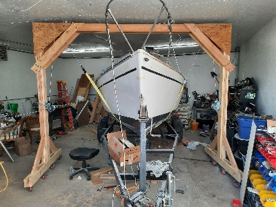

How are you lifting the boat? I need to repaint the bottom of my 26 next year, and potentially do maintenance on the keel as well. I'm not sure if or how I'm going to do it...

I’ve got the boat in a temporary shed roofed with a tarp. The six posts are pressure treated 4x4s. I’ve installed eyebolts near the tops. I plan on using nylon slings and come-along cable pullers to raise the boat off the trailer and suspend it high enough to drop the keel. Then I’ll add cribbing for safety once the trailer is out of the way. I was able to do all the hull work with the trailer supporting the boat by selectively removing the 4 cradle pads one by one. I’ll paint the bottom of the keel trunk when I do the swing keel.

Re: Gotta replace the broken keel cable
Built a A frame lift for mine with 2 1500# wenches worked really well . Only have to lift 1/2 the boat at a time
