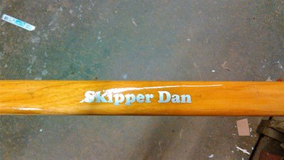

Making a new tiller is easy.
Re: Rudder
Very cool!
I love the custom name on it!

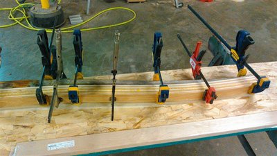

Re: Rudder
I wrap the lower part in fiberglass and overdrill the holes and fill them with epoxy. It is the last tiller I will need.
add a tiller cover from left over Sunbrella
